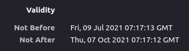

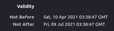

curl: (60) SSL certificate problem: certificate has expired
More details here: https://curl.haxx.se/docs/sslcerts.html
curl failed to verify the legitimacy of the server and therefore could not
establish a secure connection to it. To learn more about this situation and
how to fix it, please visit the web page mentioned above.
  [i] Checksums do not match, downloading from ftl.pi-hole.net.
  [i] Downloading and Installing FTL...curl: (60) SSL certificate problem: certificate has expired
  [✗] Downloading and Installing FTL
  Error: URL https://ftl.pi-hole.net/release/v5.9/pihole-FTL-armv7-linux-gnueabihf not found
  [✗] FTL Engine not installed
Your debug token is: https://tricorder.pi-hole.net/nf7i8cj393
Thanks for the report, there is nothing wrong with your system, the automatic SSL certificate renewal didn't work.
I'm looking at this now.
Fixed.
