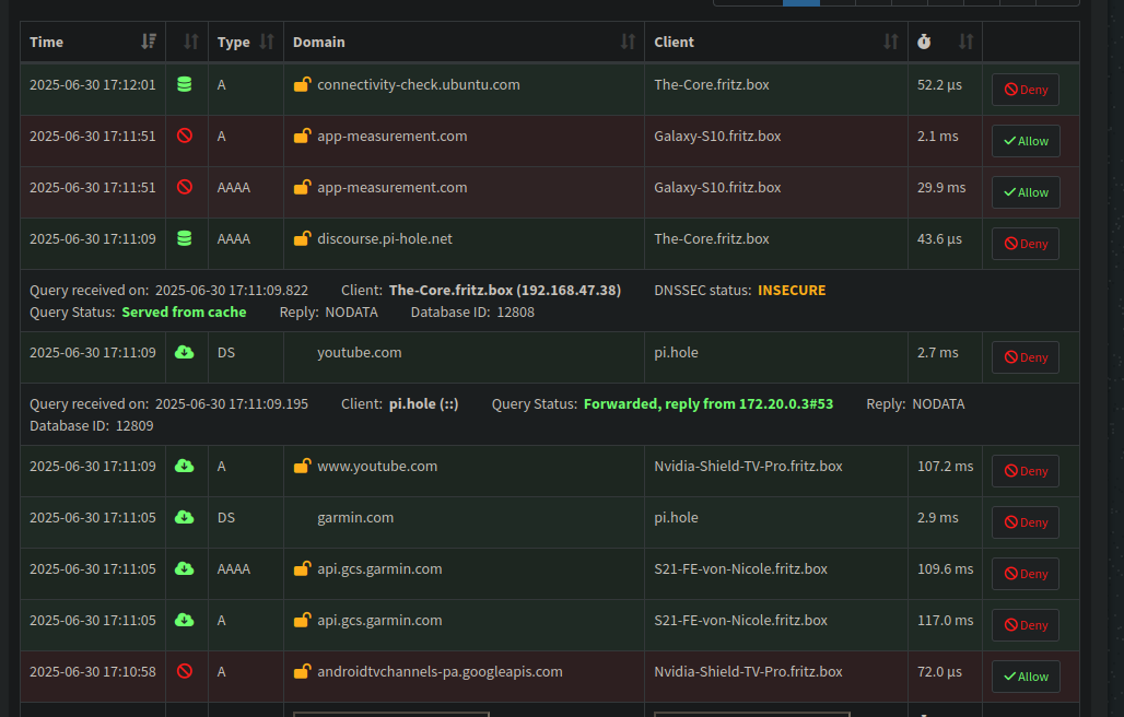

It works fine now, Unbound actually without chroot but it works.
I think its working 172.20.0.3#53 is the Unbound Docker Instance thats correct.
