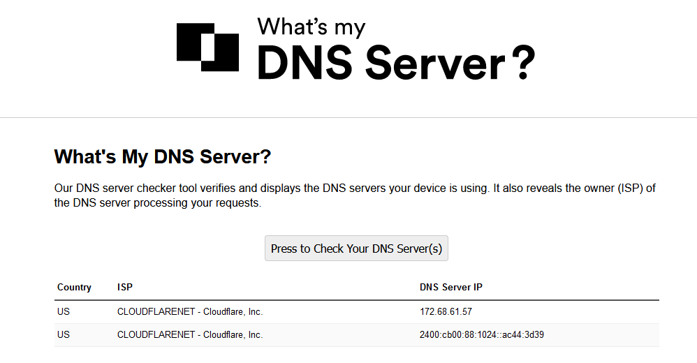

@jfb I understand what you say.
What seems weird to me is that when pihole was installed on the vm and I run https://www.whatsmydnsserver.com/ it showed that my dns server was my public ip.
Now that I have installed it on raspberry it shows cloudflare.
