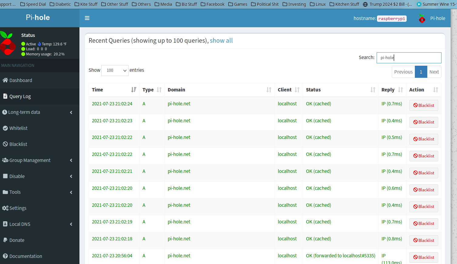

ok, here is the result...
I'm beginning to wonder (and TY Dan for ALL the help thus far!) if perhaps I may have presented my issue correctly - the ultimate goal is to make sure I've set this up correctly, so that unbound is running as a recursive DNS...
I will apologize, if I'm making you tear out your hair with this... :slight_smile:
this does look a LOT better though...
That set of status and replies appears completely normal, given that screen alone. If these are all first queries, you would expect them to not be served from cache.
