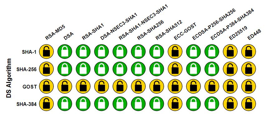

Maybe a bigger screenshot to see it.
you can have it set either way when running unbound. if it is not DNSSEC compliant unbound will reject it anyway so you will always see either unknown or OK in that collumn within Pi-hole

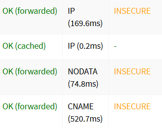

I just ticked the DNSSEC Box to try it. Mostly to be able to see the DNSSEC Validation in the Query Log, but this got me curious:

And if im on https://rootcanary.org/test.html i got this like @anon55913113
https://discourse.pi-hole.net/uploads/default/original/2X/1/15a828239803ef678bee3972dc01fa492cee8505.JPG
Also the other Tests on:
https://dnssec.vs.uni-due.de/
work perfectly fine...
Why does the Query Log says "Insecure"?
Because one link or more in the DNSSEC chain is showing it as insecure. You wont see any BOGUS as those will be rejected by unbound So from that we can infer that it is dnsmasq causing it and it really is a non issue as insecure does not prevent access

If this "Insecure" Warning is not an issue and unbound and the DNSSEC Chain is ok, then i'm happy. Just a little bit confusing for not so advanced users :smiley:

So this insecure warning is just a little dnsmasq bug. Thank you :wink:
Insecure just means that the domain does not have any DNSSEC information.
It's telling you that it's not validated as secure, thus may be insecure.
Think of it like HTTP vs HTTPS
