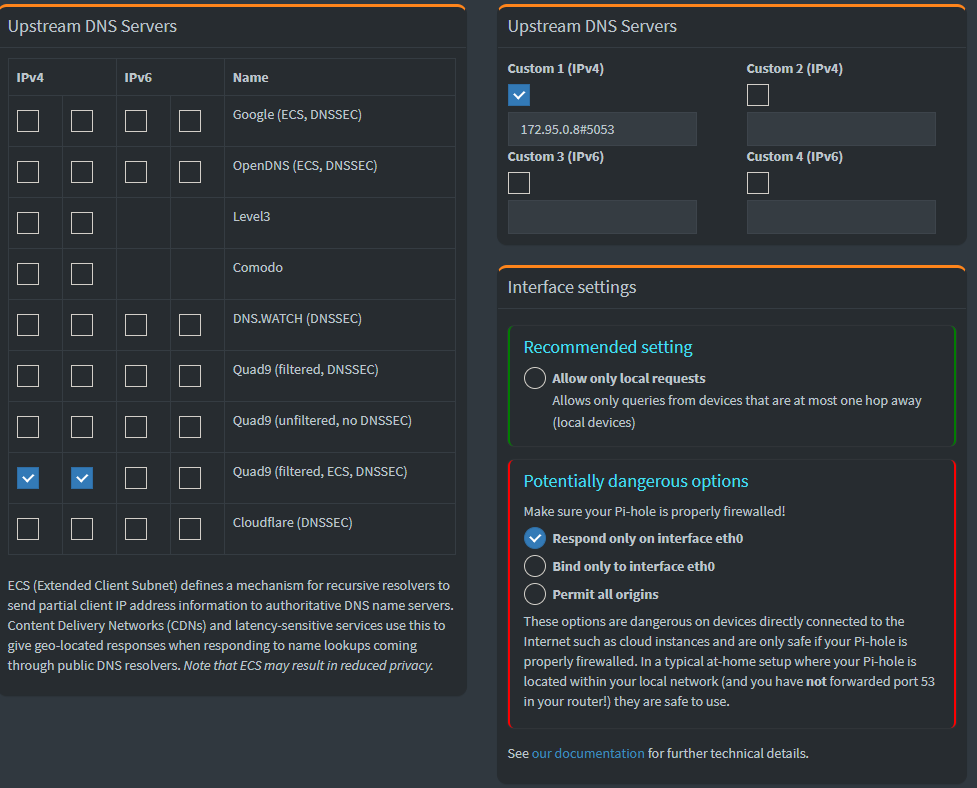

Hi everyone i have installed pihole + unbound. However, i cannot use custom dns server only.
To access internet i need to pick cloudflare or other dns servers.
Otherwise its giving the error on browser that
DNS_PROBE_STARTED

Your image does not show the unbound IP.
It should be something like 127.0.0.1#5335.

You are using the wrong subnet range.
Docker uses IPs within 172.16.0.0/12 range (from 172.16.0.0 up to 172.31.255.255).
You need to change the IPs in your compose file, unbound and Pi-hole settings.
You are running unbound and Pi-hole as Docker containers.

i have changed it as you said but still have problem connecting to the internet without Upstream DNS Servers.
Would be good. i have changed the settings according to this (my ip is set to 172.16.0.0/12 now).

   [2025-01-14 00:39:00.081 934M] New upstream server: 172.16.0.8:5053 (0/2048)
   [2025-01-14 00:39:00.083 934M] New upstream server: 9.9.9.11:53 (1/2048)
   [2025-01-14 00:39:00.084 934M] New upstream server: 149.112.112.11:53 (2/2048)
