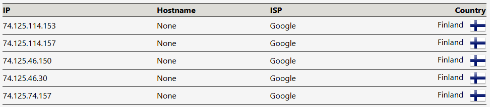

When I run dnsleaktest it shows me Google DNS servers as my name resolvers. As far as I understand I should only see my ISP WAN IP, but this behavior is only achievable if Pihole is set as WAN DNS resolver, what is not recommended by the official manual.

Google DNS showing up as name resolvers in dnsleaktest
https://tricorder.pi-hole.net/mOUpBt7J/
Those addresses aren't google's they are dynamic IPs belonging to Alaska Communications.
153.114.124.74.in-addr.arpa. 86400 IN PTR 74-124-114-153-radius.dynamic.acsalaska.net. (and so on for the other IPs listed)
Anyway, I think I must be seeing my ISP WAN IP instead, shouldn't I?
If you are on a static IP then that would be expected. If you're behind CG-NAT then it will not be your wan IP.
I am on a static IP address. I will only see my IP address if I set Pihole as my WAN DNS in the router ui.
