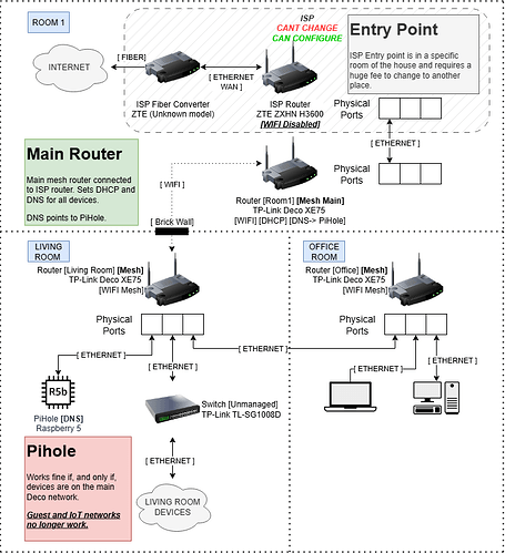

Current Network - Diagram:

I dont have experience with those, that is why I tried to set the addresses directly on the Main Deco to point the DNS to the Main ISP Router [1] that is then configured to have the DHCP to point to the PiHole[2]. (see picture above)

Altough not a priority, even if the device is isolated - on main, guest or IoT network - they will ask Deco Router for the PiHole address, and the Deco Router itself will know how to forward the requests.
