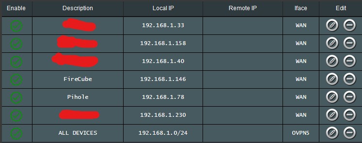

Here is screenshot of what I mean. This Asus router has VPN Director section where you can point devices to either the WAN connection or the VPN.. take a look...
I know Pihole will work whether it uses the WAN or the VPN connection.
My question is whether the Pihole should be set to the WAN connection or the VPN since all traffic is routed to it... or, it really doesn't matter?
I think we are both talking about the same thing here. From your router's point of view it doesn't care what the client called "Pihole" is doing or what its purpose is. All that screen cares about it should "Pihole" have its outbound traffic be sent to the WAN (which I assume means normal without the VPN) or the VPN.
The outbound traffic from Pi-hole is its queries to its conffigured upstream DNS servers. Plus adlist updates, version checks and so on.
So the question is should Pi-hole's upstream DNS queries be sent out as normal or via your VPN. My earlier reply references that decision.
oh ok. Sorry that's my bad for not understanding your post. So, in the end, it doesn't matter..then I will just leave it as is, to use the WAN then.
The way I was thinking about it was.. if my router didn't have this VPN Director option, all traffic will be sent to the WAN anyway..but just wanted confirmation.. thanks for your help.

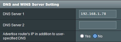

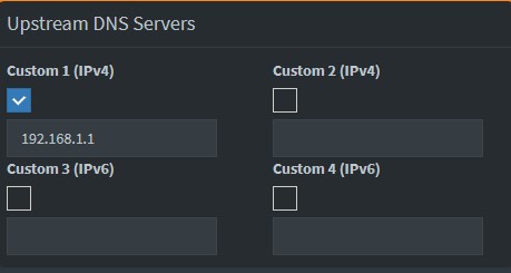

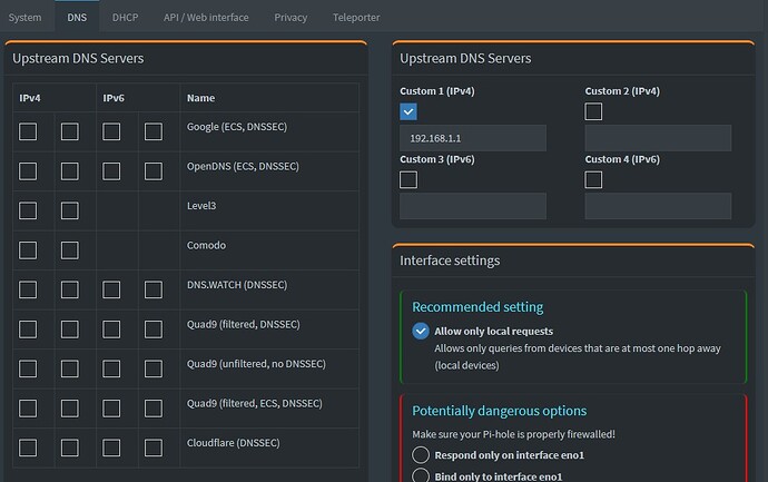

The upstream I have in Pihole GUI is the router 192.168.1.1 and the router is set to only use Pihole as the DNS server.
This will cause a DNS loop.
Pi-hole queries the Router => Router queries Pi-hole => Pi-hole queries the Router => ...

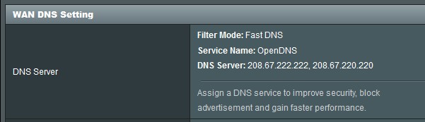

I have it so all traffic uses the pihole to filter ads, but I also use OpenDNS as the upstream to filter content.
So I said previously Pihole is the ONLY DNS server, but I forgot about OpenDNS.
Let me know if this is still a DNS loop...

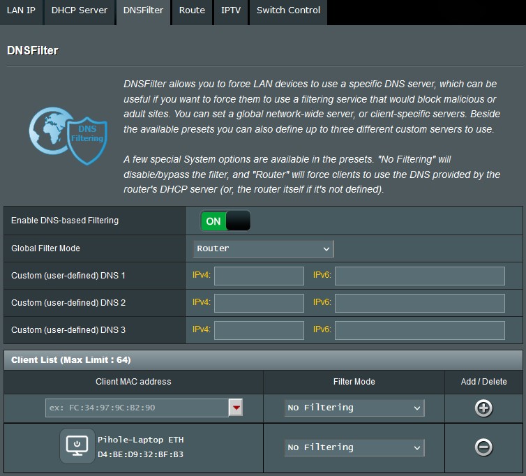

LAN DNS
WAN Upstream
DNS Filter

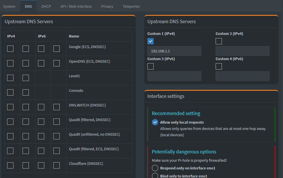

In my mind, this way would be the same as selecting the 2 OpenDNS options from the Upstream server section in Pihole GUI..right?
What would be the difference, between selecting the Upstream DNS server in Pihole vs at the router?
Isn't it supposed to be..
client ---> Pihole ---> Upsream DNS.... right?
To me that sounds about right. Your setup looks ok to me as well.
You would have a DNS loop if you had Pihole assigned as the Upstream DNS server, which according to your pics, it doesn't look that way to me because you have OpenDNS as your Upstream server.

As @Soapy writes it's working but I think it could be "tidied up" a little to simplify and speed it up a touch (fewer hops around). Your setup is secnario 1 in my earlier reply, and the final bullet point question is that you're router is using OpenDNS as its upstream.
At the moment your resolve path is:
  • Client asks Pi-hole
  • Pi-hole asks router
  • Router asks OpenDNS
As you mention you could change the Pi-hole upstream to be the same OpenDNS servers directly, by selecting both IPv4 checkboxes, and remove the Custom 1 entry for the router. Now the resolve path would be:
  • Pi-hole asks OpenDNS
The router's LAN DNS is still there but no longer being asked for anything. This will always be the case with these home routers, they come with DNS included but Pi-hole can take over the role no problem, putting the router's DNS on the sidelines. Always good to know the router's DNS is still there to be used once again if ever needed.
Meanwhile your router's DHCP settings are okay, it is handing out the Pi-hole for LAN DNS. And the router's VPN/WAN setting is also good set to WAN, this will allow the Pi-hole to access adlist updates, Pi-hole updates, OS updates, etc directly without dragging it all through the VPN. That remains a question of who you trust, ref my first reply.
All in all a good setup. How is Pi-hole working for you? Hopefully working well and catching a lot of stuff.
