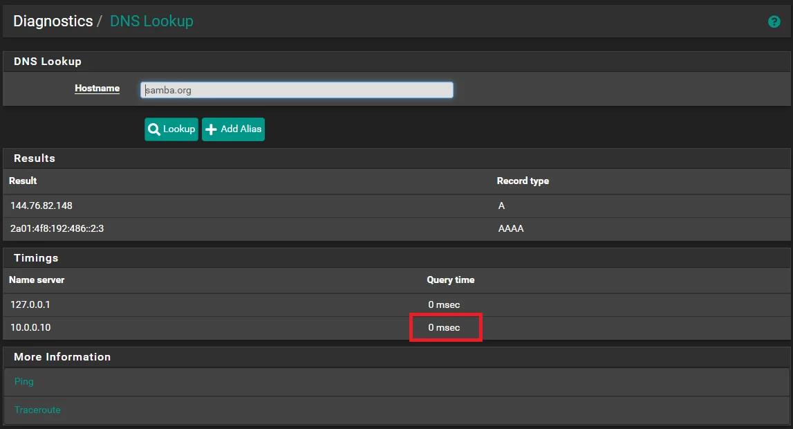

Dunno if this helps but this is what I see in the logs :
If I use an external DNS like Quad9 or Google the issue goes away. How do I mitigate this issue ? Maybe this will go away after pihole and unbound's cache is primed ?

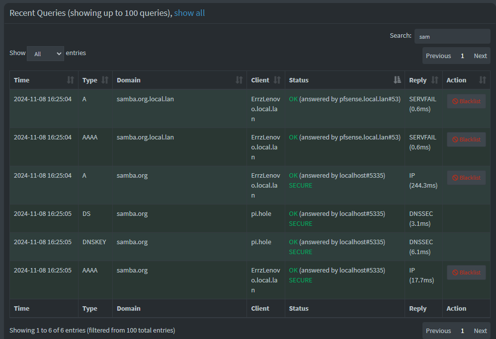

To analyse your issue, you need to monitor Pi-hole's Query Log when you try to open a website and actually encounter those messages, to see if your browser's resolution requests associated with that site do register in Pi-hole, how Pi-hole has handled them, and to share the actual browser message as you observe it.
Your above Query Log screenshot suggests that you've just run an nslookup for samba.org, which wouldn't give us any of those details.
It does, however, demonstrate that your pfsense.local.lan has a problem resolving samba.org.local.lan, as it replies with SERVFAIL where NXDOMAIN would have been expected. This is unlikely to contribute to your observation, as a browser would usually not send queries expanded by your local domains, but it may warrant separate attention.
