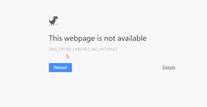

The issue I am facing:
When PiHole is running, and I go on a webpage it states "DNS Probe Error" and gives me the dinosaur. When I use my routers DNS server, i.e. don't go through PiHole, it works.

Make sure that your device running Chrome is using Pi-hole as its DNS. Try also clearing Chrome's cache.
I don't think that's it, as the issue occurs on all browsers and TV (Netflix etc) and Android says "connection limited" under the WiFi network.
