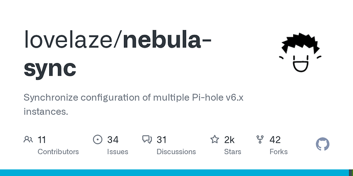

I do have a nebula-sync running (but that's every 15 minutes) and I'd just disabled that.
