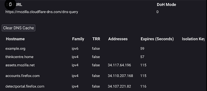

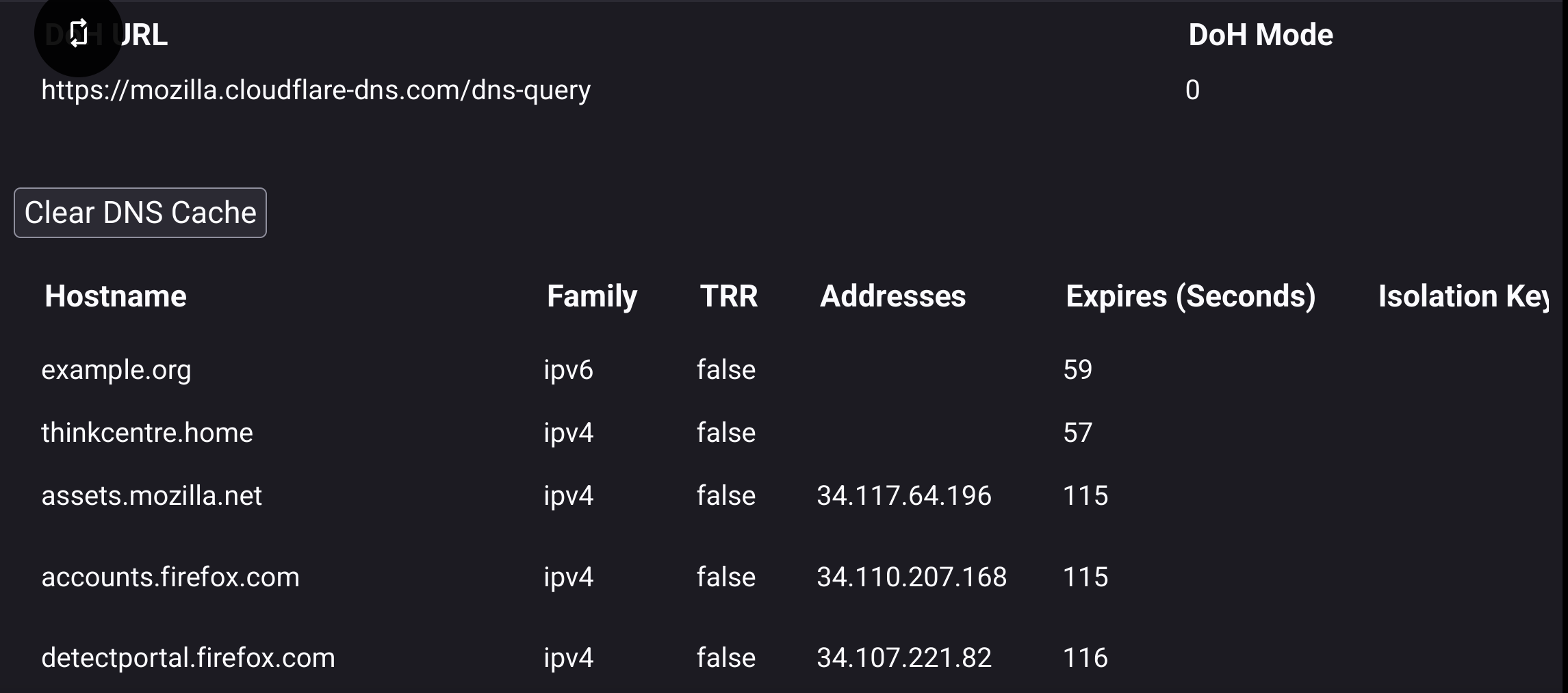

Even when I empty the DNS cache forcefully I am not able to resolve the address on Firefox for Android
I know this isn't just a Firefox issue because other apps using the local TLD also can't resolve the address. For example I can't connect to my sftp directories or to the qbittorrent remote client. When I try to browse other websites I correctly see my device in pihole query logs too
This is what I see in the pihole.logs when I tap on refresh on my phone while being on thinkcentre.home (which should be resolved thanks to the local DNS rules):

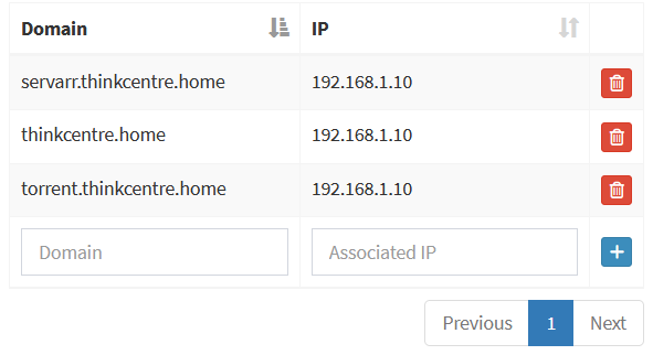

and this is my local DNS:
