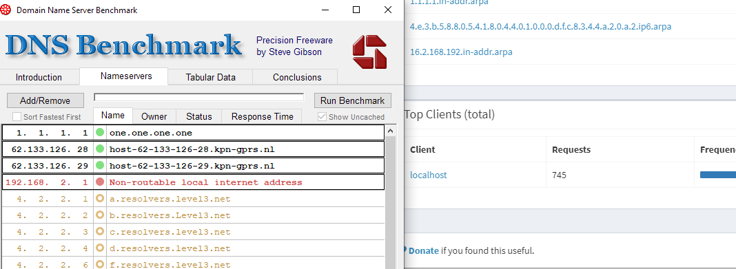

_[-Dashboard shows localhost as the only client.
  • DNSbenchmark say: Non-routable local internet address.
  • NSlookup from W10 client says: DNS request timed out

DNSBench and nslookup do not get an answer from your local DNS server.
However, DNSBench also reports your local DNS to be a .1 address - that's likely your router, isn't it?

server=2606:4700:4700::1001
domain-needed
bogus-priv
interface=eth0
except-interface=nonexisting
uinerface is not a valid option for dnsmasq - a typo?
Does it read interface=tun0 instead?
With only these lines, your VPN would not be operative, as now tun0 is missing.
If your custom 02-ovpn.conf contains interface=tun0 as noted above, that should make up for a working configuration.
I also just noticed that this post is basically a reincarnation of your last year's Pihole DNS on RPI does not resolve from Windows, not from RPI address, works through piVPN, where an equivalent solution was proposed. :wink:
Thanks for all your help.
Of course it's interface :wink:
Next tests show that everything is going smooth as long as I don't install unbound.
So now my config is without unbound. :slight_smile:
I followed the instructions on Pi-hole as All-Around DNS Solution exactly, changed do-ip6: no to do-ip6: yes.
Then at the bottom of the page: Finally, configure Pi-hole to use your recursive DNS server:
I added :::1#5353, unticked the Upstream DNS servers and added interface=eth0 at the end of /etc/dnsmasq.d/01-pihole.conf
And then it still failed.
I must have missed something somewhere.
