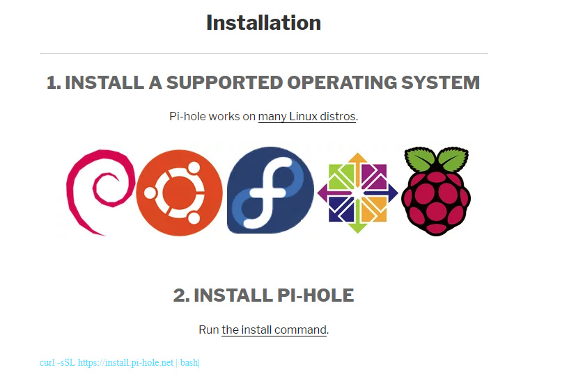

Shoot... Can it run on Windows :slight_smile: ?
No you cannot. It only supports the following platforms:
https://pi-hole.net/
