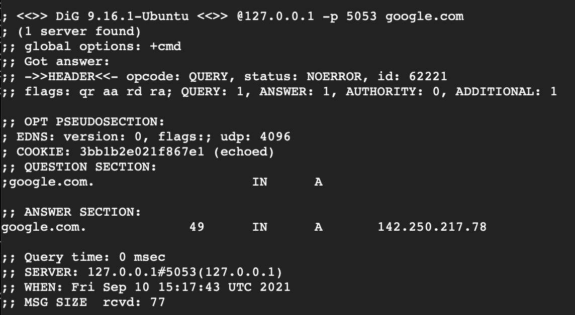

and did a DIG :
I don't know if it's good or not ...
I have no issue with my Pihole at home (the only difference is that i m not cloudflared ...)
