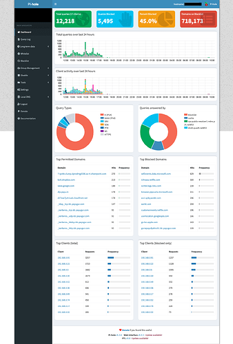

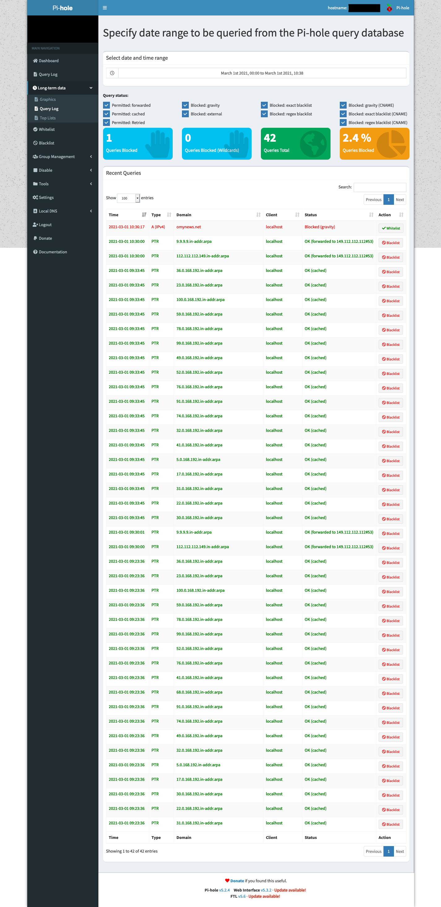

All DNS queries for the last 12-14 hours are missing from both the dashboard and the "Long Term Data -> Query Log" interfaces. ALL client queries. Please see the screenshots below:

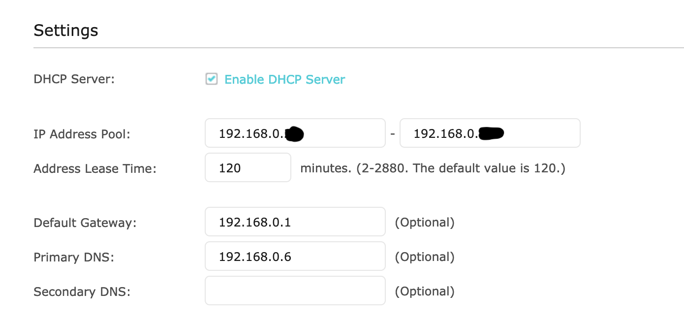

My router (under DHCP) has 192.168.0.6 as the DNS server. No other DNS server is configured in the DHCP section.

My Router DHCP configuration:
Okay. Your router definitely announces itself as DNS server. You can check this by running
sudo pihole-FTL dhcp-discover
and seeing it returns two DNS server fields:
Try filling in the IP of your Pi-hole also as Secondary DNS server and check again with the dhcp-discover feature.
