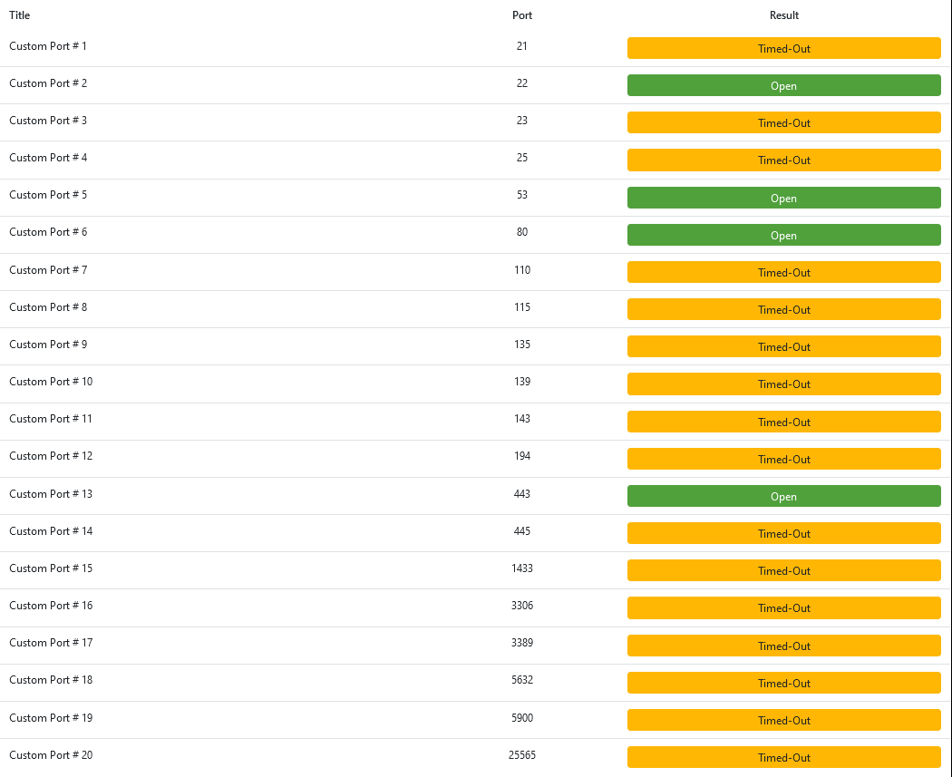

Ports are open:
https://dnschecker.org/port-scanner.php?query=<YOUR_EXTERNAL_IP>
Also, http://<YOUR_EXTERNAL_IP>/admin/login.php shows Pi-hole web interface login page.

You closed all ports except port 22. Make sure your server is save.
