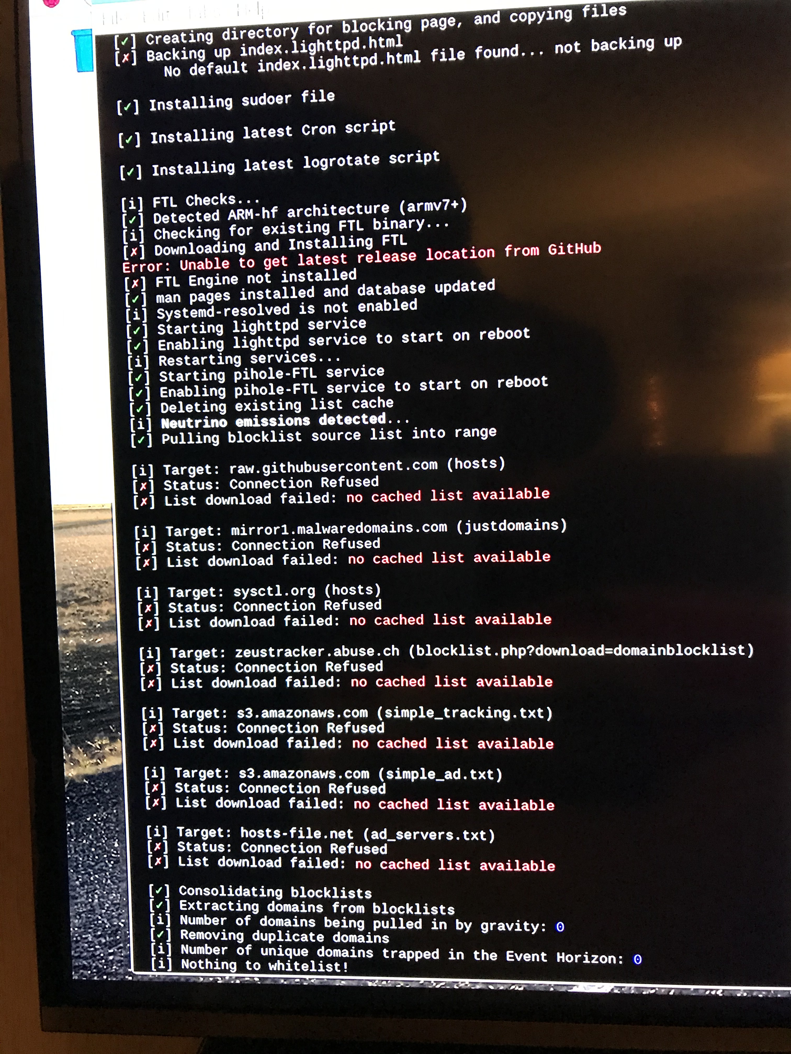

I’ve tried to install the Pihole starter kit to my network which has a BT Smarthub modem/router. I followed the instructions but got a number of errors during the install: Index not backed up, FTL engine not installed, blacklists downloads failed, (see screen shot
I disabled the Smarthub DHCP and enabled this in the Pihole. Devices on the network where allocated IP address OK but I could not access (or ping) the internet. I guess the install errors could have been down to failure to access the internet.

Running pihole -d generated an output log but could not upload it (attachedpihole_debug-sanitized.txt (20.2 KB) ). No debug token was generated.
