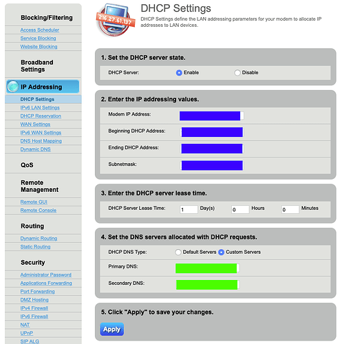

I tried using the routers DHCP initially, but could not get it to work. Below is a screenshot of my routers settings. From what I understand changing the Primary and Secondary DNS options to the pihole's ip address should be all I need to change correct? Then I should disable the piholes DHCP. Then I need to reboot the router and all devices or is that not necessary?

Typically, yes. Sometimes you leave the second DNS blank (varies by router).
But you should also go through every menu on the router and look for DNS settings (dynamic DNS, prebinding, family friendly DNS, etc.).
It is necessary, but you also want to look in each client and make sure it's DNS cache cleared during the reboot. This will get the client to use the DHCP from the router and not from the Pi-Hole.

I was able to switch DHCP from pihole back to my router. There was a primary/secondary DNS setting under WAN settings that I had missed. It was set to default, and didn't display unless I selected to manually change it. I then rebooted the router and all client devices. Everything connected instantly to the internet.
Disabling pihole now immediately displays ads. Enabling still does not immediately block ads but, as pointed out, this is due to the router caching. I'm fairly certain this is so as checking Block Ads! Adblock test right after enabling shows that adblocking is enabled.
