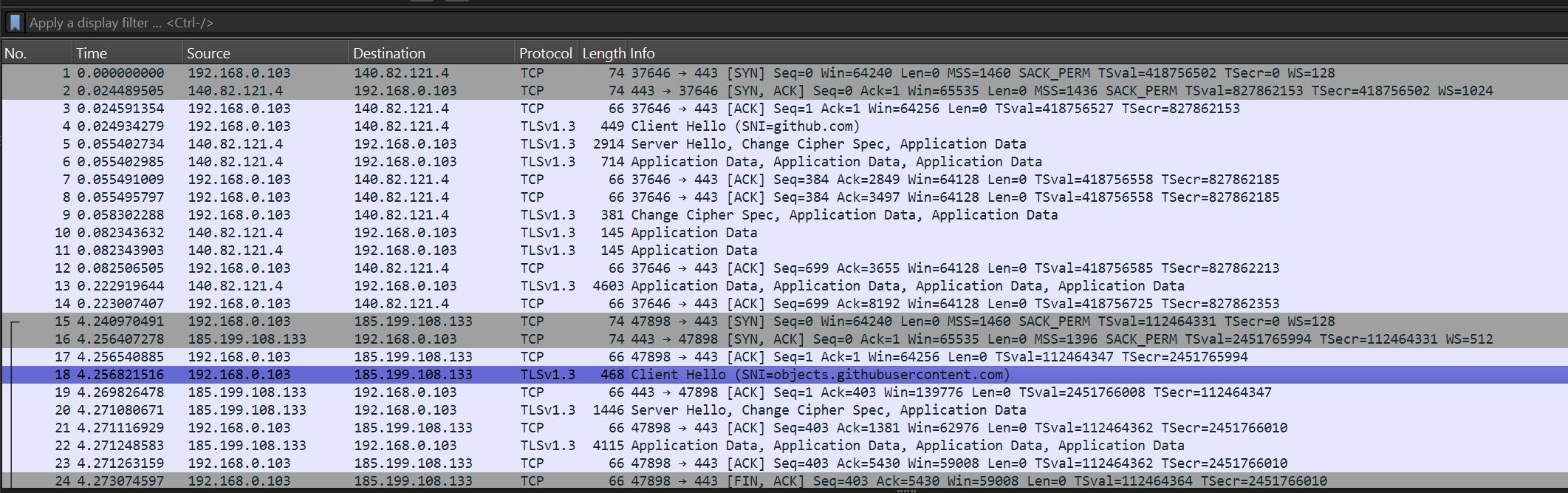

i got some wireshark information, im no expert at wireshark but i filtered it for host github.com and did the action that causes errors, i don't see any personal information in there other then local ip's so im just gonna dump it here.
foundryerror.json (227.6 KB)
and here's what happens if i disable pi-hole container.
foundrypioff.json (268.4 KB)
EDIT: those logs are incomplete, missing host objects.githubusercontent.com
cant directly upload those here so random share website it is!
i hope that helps with the vagueness, i cannot do a dig since i cannot directly replicate what foundry does, but hopefully that wireshark log will tell you everything that happened from a network perspective.

From the error json:

ip.dst is a github IP address, so Pi-hole properly resolved to GitHub.
I need the pcap or a file I can import in to Wireshark.
Looks like the problem is on the remote end.
github.com is successfully resolved and connected to. (Client Hello SNI)
You're redirected to objects.githubusercontent.com and that domain name is resolved correctly. SNI passes.
You'll need to ask Foundry what is going on. Send them these caps. All Pi-hole does is resolve github.com and objects.githubusercontent.com to IP addresses and that is working and the SNI passes so you are not being intercepted to a non GitHub server.
