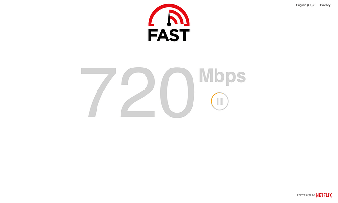

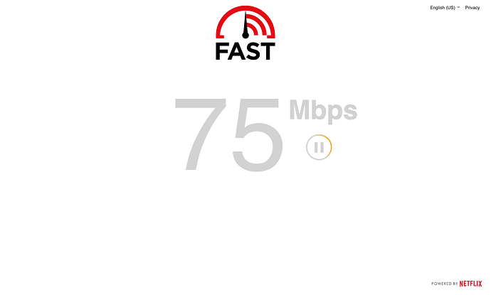

Please take a look at the images below. The first one is with pihole on and the second one is with pihole off.

This is with PiHole turned ON
This is with PiHole turned OFF

Are you able to verify if those test's were to the same target IP?
DNS would only be involved in determining the speedtest domain's IP address.
By itself, it has has absolutely no impact on download speeds - once that IP address is known, the download communication is via that IP.
However, depending on your choice of upstreams for Pi-hole, an upstream DNS server may provide a different IP address for the speedtest's domains - you may end up with a target IP that is located further away from you, negatively impacting download speeds.
This would then highlight an issue of the speedtest's fragility, rather than DNS actually slowing down download speeds.
