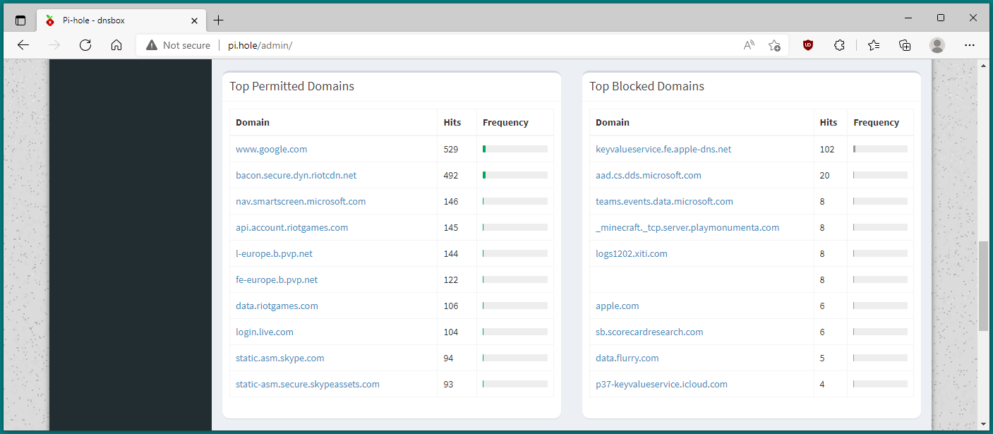

and open the web interface, I am seeing an empty entry in the "Top Blocked Domains" window as depicted with:
Can anybody enlighten me how may I come to such a situation? How can I rectify this?

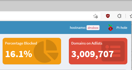

Yes, I do have the the "uBlock Origin" ad blocker installed on my web browser, though it says that nothing has been blocked as depicted with:

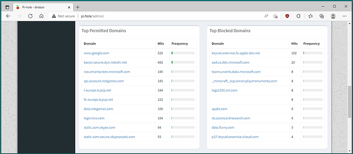

Today, I ran across the same situation as described above that the "Top Block Domains" window shows an empty line next to its counter and the add-on "uBlock Origin" module does not visibly show any blocking activity on the browser bar despite hitting the refresh button on the Edge navigator as depicted with:
Firing the command "echo ">top-ads(10) >quit" | nc 127.0.0.1 4711" on the terminal windows displays the following results:

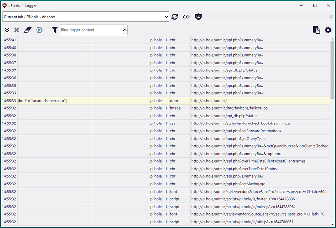

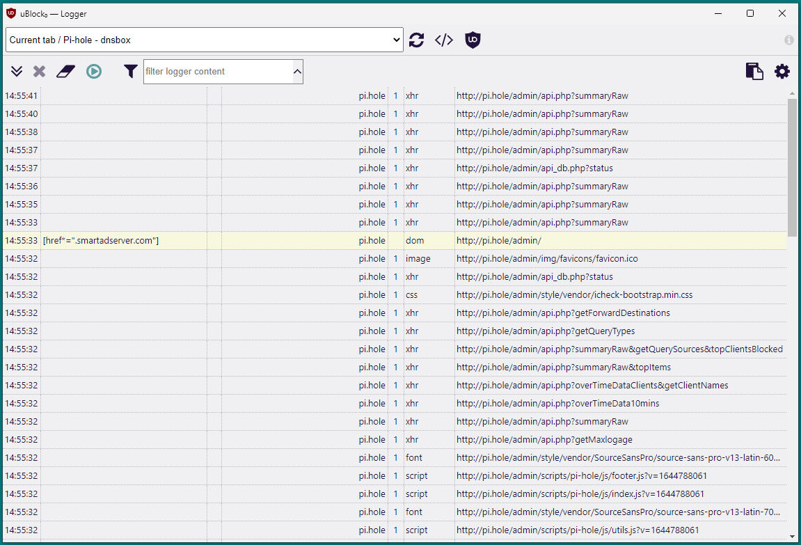

Checking with the "uBlock Origin" logger window, it does indeed show that a domain is being blocked as depicted with:
Anything that can be done here to rectify this misperception ?
Your findings confirm that it is indeed uBlockOrigin that filters ww13.smartadserver.com from Pi-hole's web page in your browser.
You'd have to address this in uBO.
The simplest approach would be to disable uBO for pi.hole.
Alternatively, you may consider to determine the blocklist in uBO that is responible for that filtering and file an issue with its maintainer.

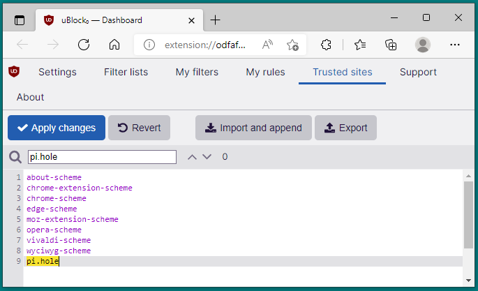

Double-checked the setup and configuration of the uBlock Origin web browser add-on, and have found the solution:
  • simply open the uBlock Origin dashboard window,
  • under the "Trusted sites" tab, simply add the domain name "pi.hole", and
  • click on "Apply changes" as depicted with:
This did indeed solve the problem. Needs to be documented somewhere as a little FAQ item :slightly_smiling_face:
Or just click the disable button for pi.hole in uBO's menu (which does the same):
That's what I referred to with: :wink:
