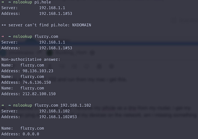

yes, my pihole lives at 192.168.1.102 and run from my mac i get this.
fun thing is, as i mentioned in my edits, after i remove my pihole as a dns from my router, i get my internet back and i can ping my router and all of my devices on the network. am i missing something here?
Did you run those from a client as requested?
That client isn't using Pi-hole for DNS, but your router at 192.168.1.1.
Your router is capable of providing resolution of public domain names, but it is not returning the 0.0.0.0 block for flurry.com (of course).
This would imply that clients should be able to use 192.168.1.1 for DNS without issues (but by-passing PI-hole's filtering, of course :wink: ).
The last nslookups demonstrates that Pi-hole is correctly receiving and filtering DNS requests - provided those requests would go to Pi-hole.
