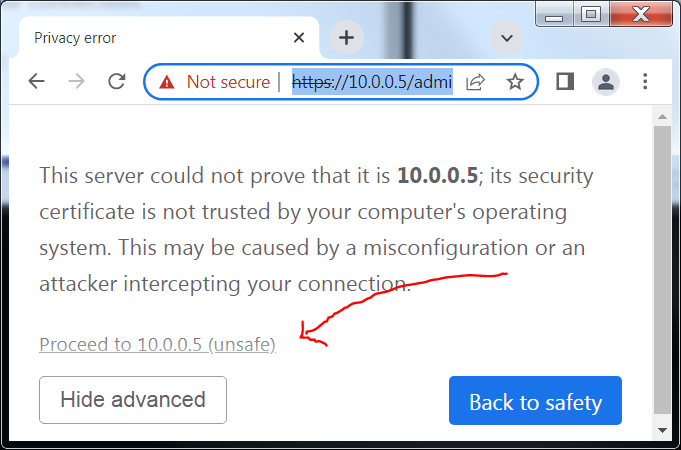

it was not pihole, it is google chrome. for some reason it isn´t able to trust self signed certs.
Greetings
You would have to add the Certificate Authority that signed the cert as a trusted CA.

$ curl -Ikv https://10.0.0.5/
* Server certificate:
*  subject: CN=pi.hole
*  start date: Jan  1 00:00:00 2001 GMT
*  expire date: Dec 31 23:59:59 2030 GMT
*  issuer: CN=pi.hole
*  SSL certificate verify result: self-signed certificate (18), continuing anyway.
