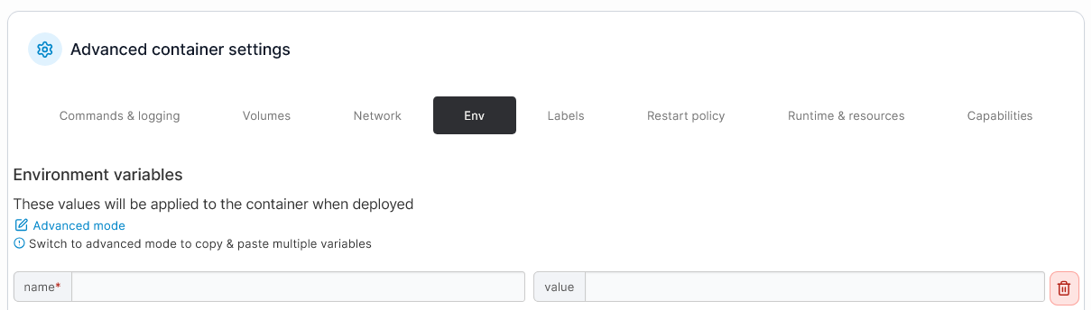

This is an Environment Variable.
In the "Create container" page, scroll down to the end. Select the "Env" tab and type the variables and values:
Suggestion:

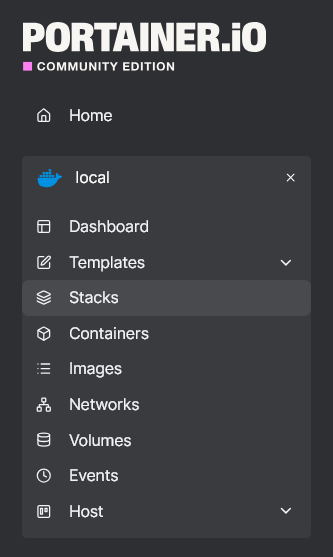

Since you are using Portainer, my suggestion is to avoid the "Create container" page and use "Stacks" instead.
First stop and delete the current container.
Then go to Stacks page:
  • click on the "+ Add stack" button;
  • give a name to the stack and, in the editor are below, paste our compose file;
  • edit the desired ports, env variables and paths;
  • scroll down and click on the "Deploy the stack" button.
This will start a new container.
