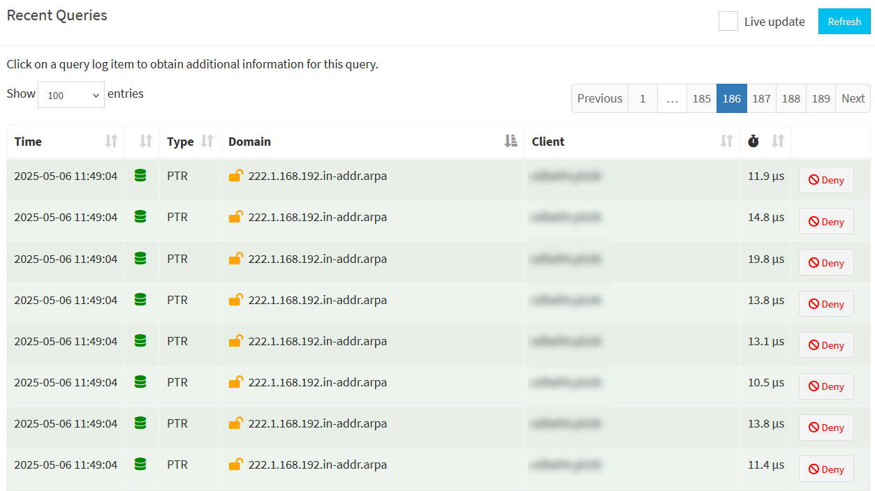

I have pihole v6.0.6 running on a Ubuntu 22.04 VM (not docker) on a Windows host.
pihole is also my DHCP server (I have the ISP router's DHCP server disabled).
Windows host: 192.168.1.220
pihole VM: 192.168.1.222

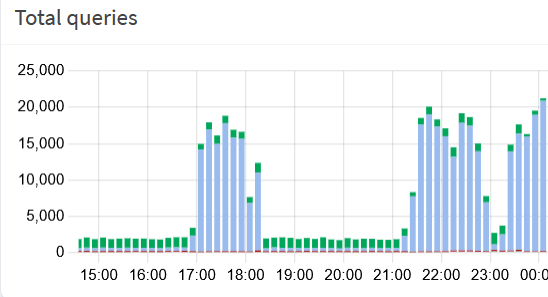

The issue I am facing is that the host is sending PTR requests to pihole for 222.1.168.192.in-addr.arpa continuously. It is hitting the rate limit (2,000 queries / 60 seconds) every minute, there would be many more requests otherwise.

1- was already done
2- was already disabled
3- this just disables logging, does not fix the issue
4- the host and the VM don't have the same MAC addresses
5- nothing obvious on the host that can be generating those requests, haven't run wireshard though
6- this does not fix the issue
Also, this does not seem to be happening all the time, it happens for an hour or 2, then stops for a while... then comes back, and so on.
