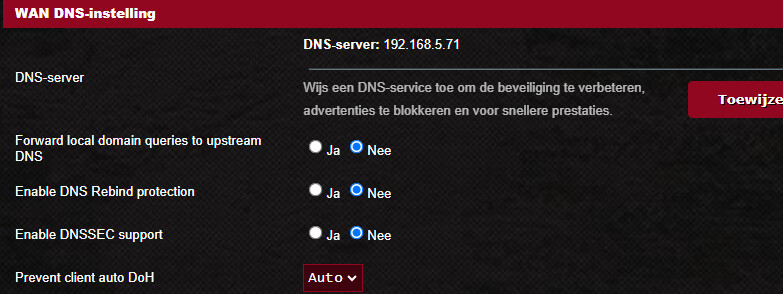

Set my router in to pihole adress:

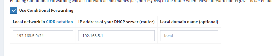

And in Pihole also the network:

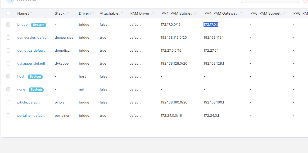

In docker a lot of things are different
Or do i need to use a docler ip adress:
