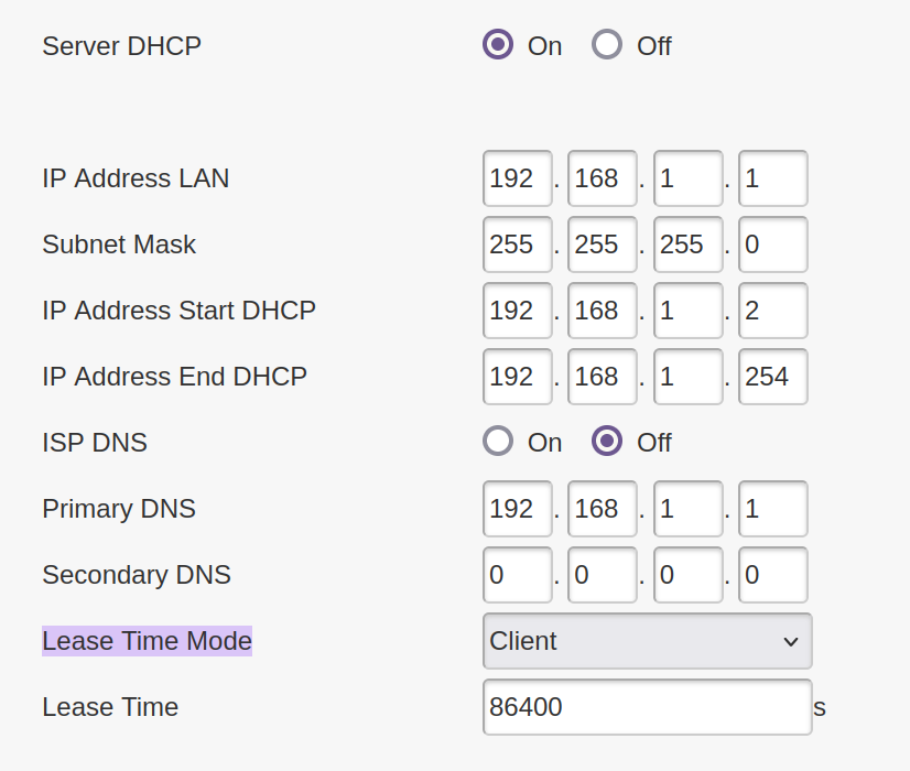

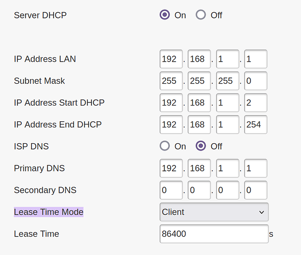

Have a read below:
Above you only have to enter the Pi-hole address in the "Primary DNS" field.
And if the router allows, you could also enter the same Pi-hole IP in the "Secondary DNS" field which is the default for the upcoming v6 release if Pi-hole's own DHCP service is enabled:
$ sudo pihole-FTL dhcp-discover
   dns-server: 10.0.0.2
Usually no other router settings needs changing so leave them on default for diagnosing.
