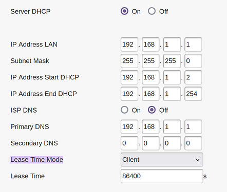

This is the page on my modem related to DHCP/DNS Settings (after a modem reset):

Above you only have to enter the Pi-hole address in the "Primary DNS" field.
And if the router allows, you could also enter the same Pi-hole IP in the "Secondary DNS" field which is the default for the upcoming v6 release if Pi-hole's own DHCP service is enabled:
$ sudo pihole-FTL dhcp-discover
   dns-server: 10.0.0.2
Usually no other router settings needs changing so leave them on default for diagnosing.

Hi, thanks for taking the time to reply.
I purged everything and went with the previous version of Raspberry Pi OS and managed to disable DHCP on the modem.
Now I'm running PiHole in DHCP mode and everything works just fine.
Just for testing, I tried putting again Raspi static IP as both Primary and Secondary DNS IP and it still didn't work. I'm not an expert but I think the modem may have fallback DNS, I don't know.
Using a previous version of the operating system may be less secure, but PiHole is literally the only application running, so I don't think it will be an issue.
