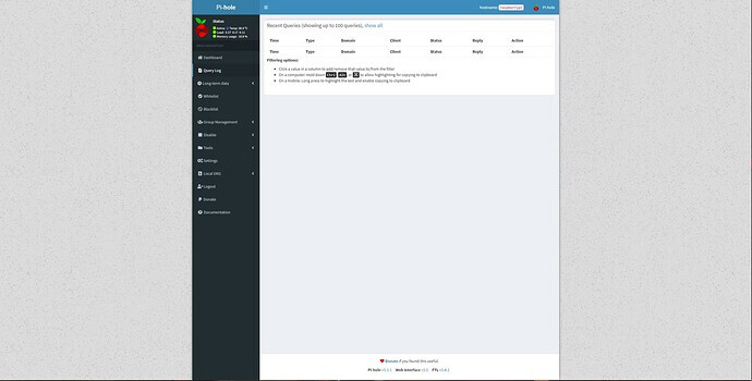

query log on the pihole web interface shows all queries
no dns queries show although pihole is working correctly, tail pihole.log is also working
https://tricorder.pi-hole.net/bOYoFVR6/
Please post a screen shot showing what you see in the query log. In this forum, you can paste an image directly into your reply.

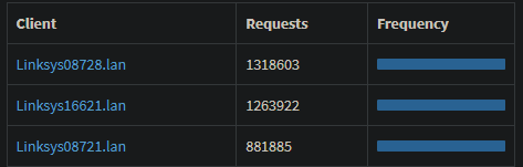

no the logs are the same. Ive noticed that my linksys nodes are requesting a abnormal amount, could this be linked to the issue?
I don't know. I don't think so but thanks for mentioning it.
