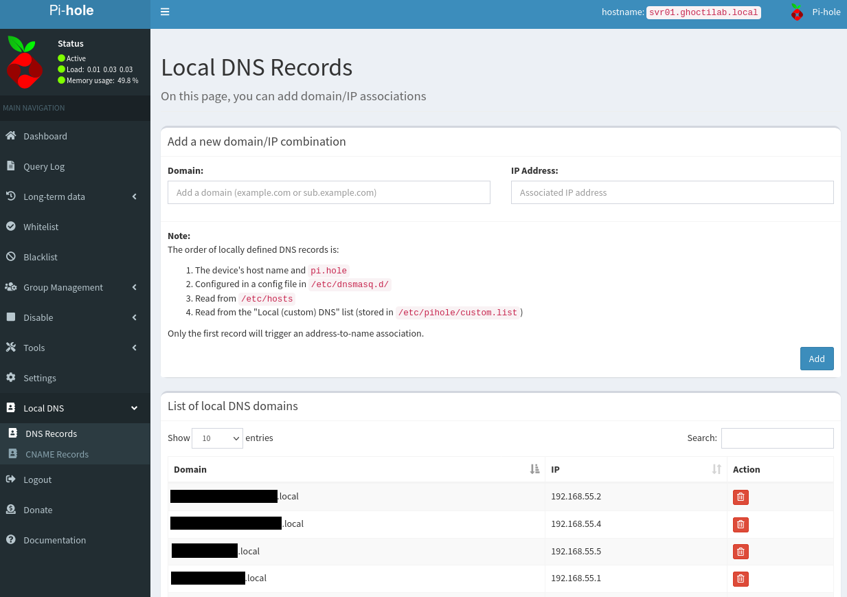

Pi-hole has some internal domain records, as shown below:

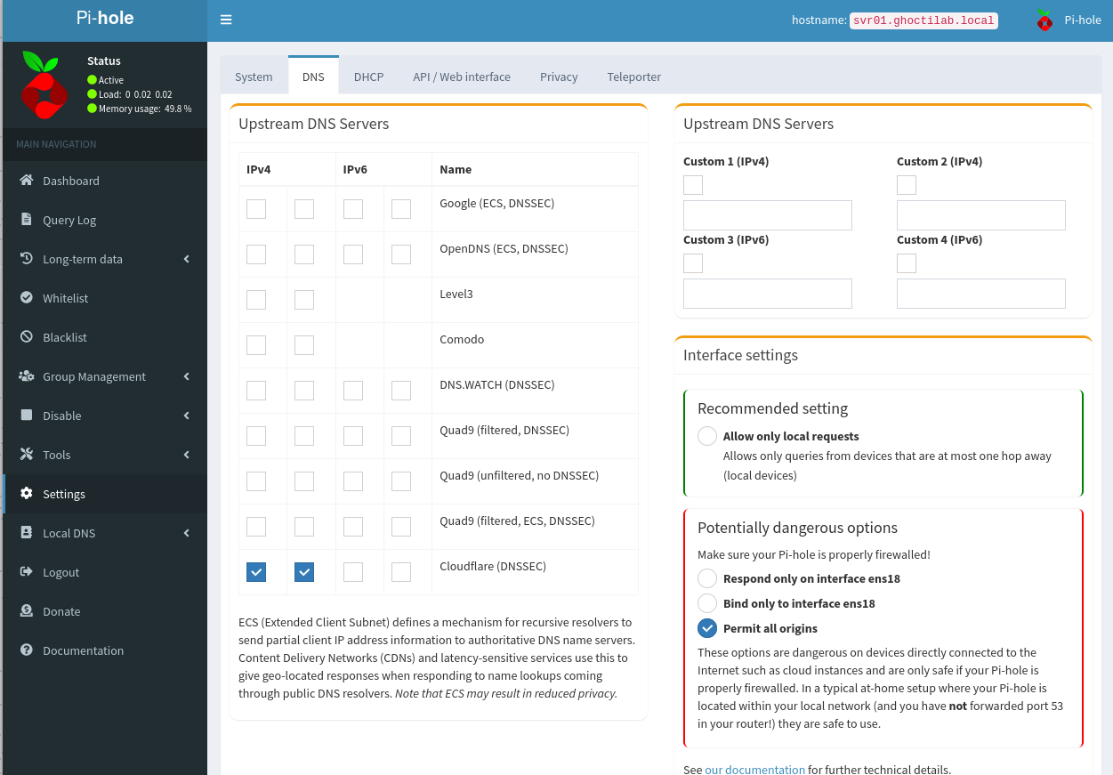

I've also configured Pi-hole to resolve domains requests coming from outside the network, as shown below:

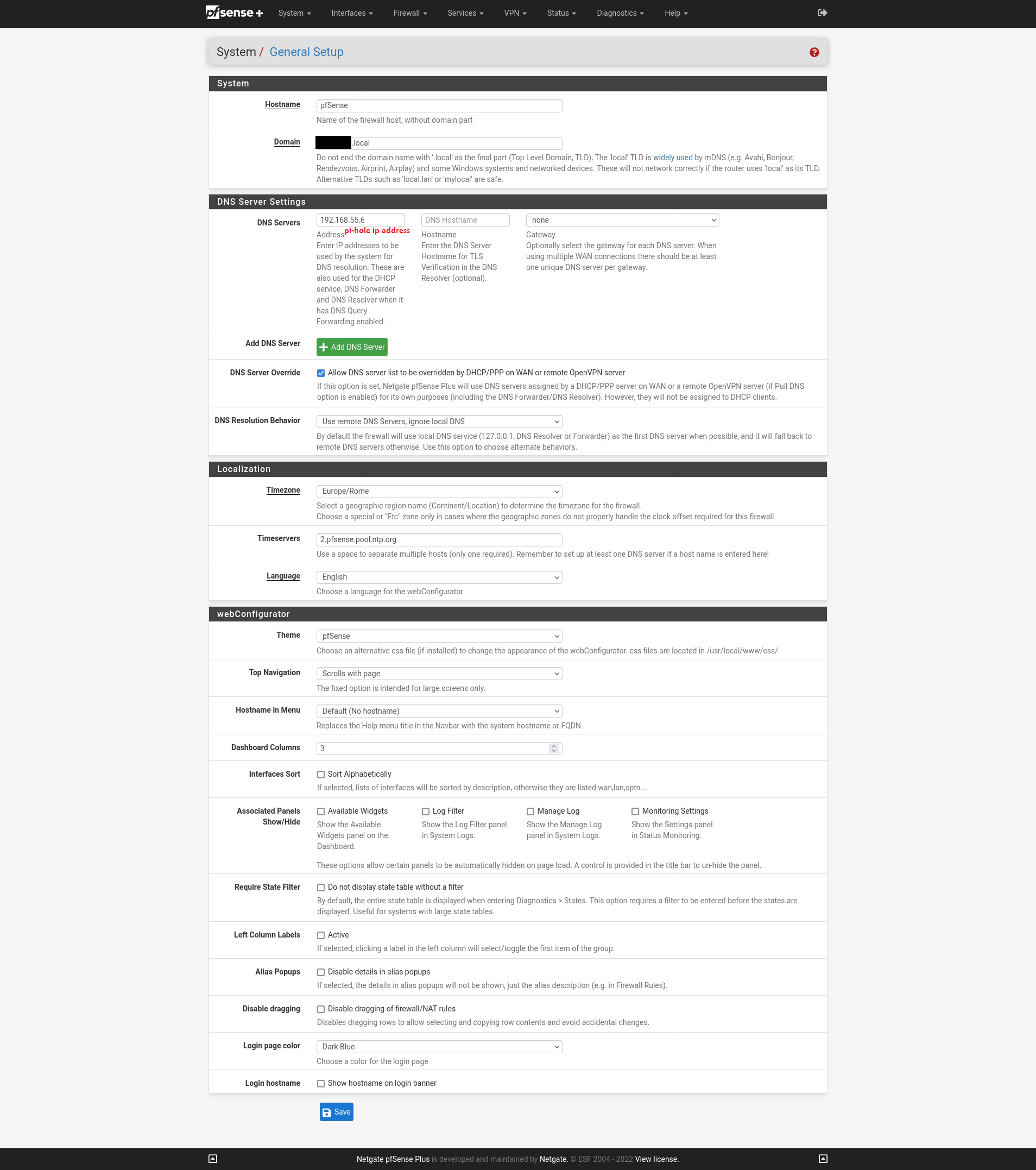

The below is my pfsense general configuration:

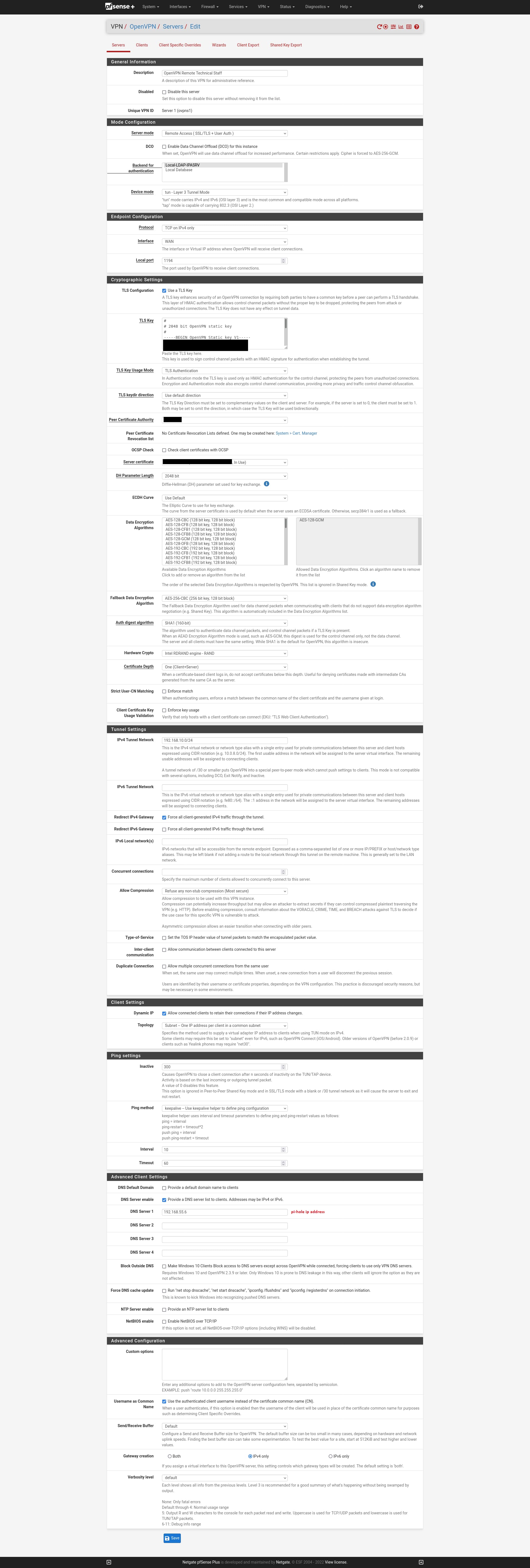

Pfsense Openvpn Server configuration:

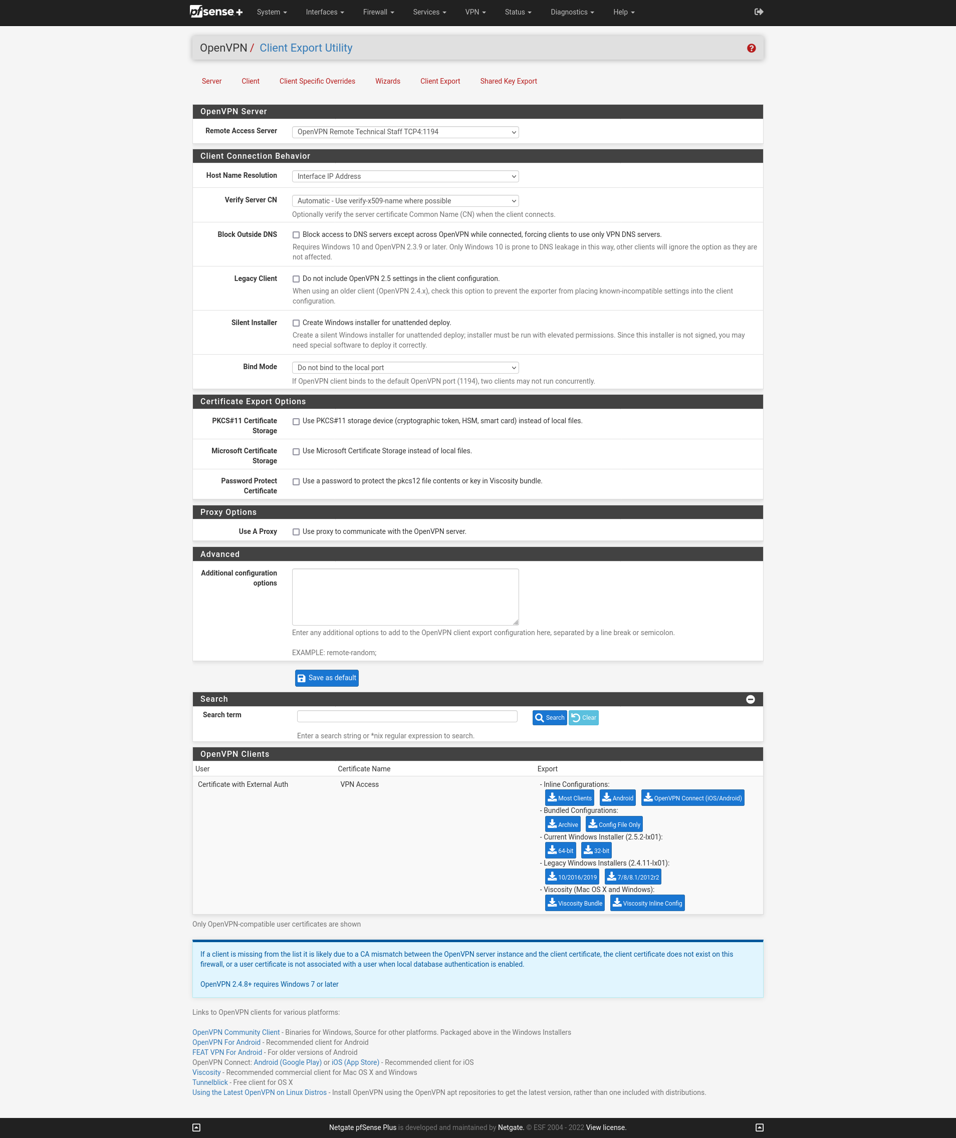

Pfsense Openvpn Client Export:

That sounds as if your OpenVPN wouldn't push your Pi-hole's IP address to be used by OpenVPN clients.

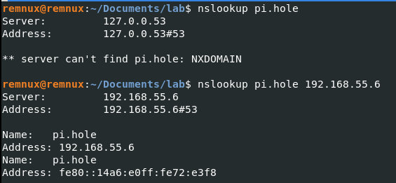

Please find below the output requested:

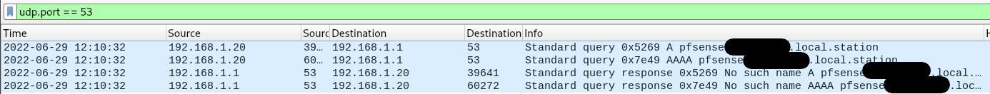

I also performed additional check with wireshark:
The DNS request is performed via the default interface and not through my TUN interface.
Was that lookup issued from an OpenVPN client as requested, or was it run from the machine hosting Pi-hole?
The first nslookup shows that machine to use a local stub resolver at 127.0.0.53.
That's ok for a client for caching puposes, as long as that resolver would use the correct upstream name servers.
In case of a client, that should be Pi-hole.
In case of your Pi-hole host, any upstream matching your preferences would do.
