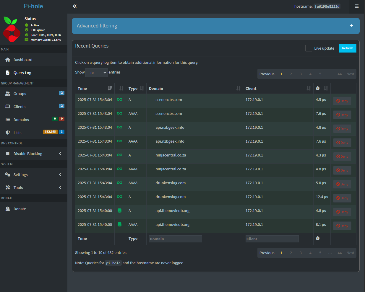

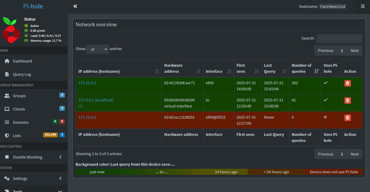

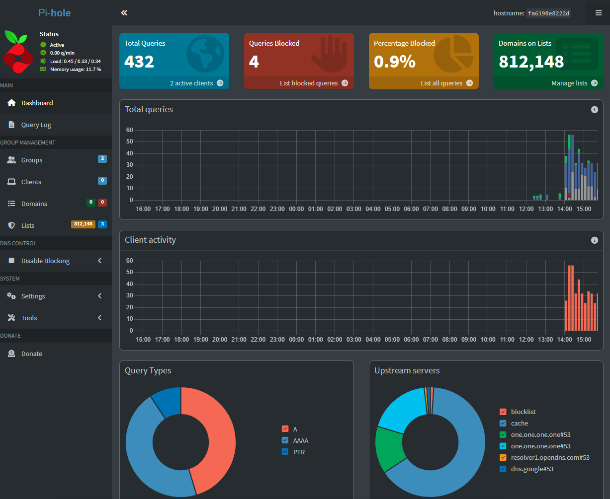

I have a problem where pihole seems to be overriding either unraid's dns setting or the individual containers dns when using a custom network (br0) but not while using a custom docker network (docker network create). When pihole uses the br0 network mode, other containers like prowlarr starts having dns issues. In prowlarr's case it can't connect to the indexers like drunkenslug. But if I switch pihole to use its own docker network, the issues disappear, but pihole can still see what is happening in for example prowlarr because there's a bunch of api hits to different things and queries to sites like drunkenslug.com. It's even blocking some of the queries.

and here's some pictures of the gui:
