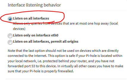

EDIT: ow and try change into below setting on the Pi-hole web GUI settings:
And try do the DNS lookups again:
host pi.hole 127.0.0.1
host pi.hole 10.0.0.128

Setting listening to all interfaces didnt change a thing:
pi@raspberrypi:~ $ host pi.hole 127.0.0.1
pi@raspberrypi:~ $ host pi.hole 10.0.0.128
pi@raspberrypi:~ $
