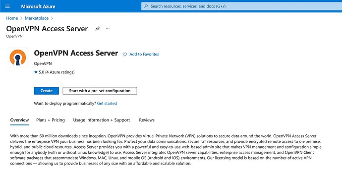

I'm running OpenVPN on Azure which was deployed from the Azure Marketplace.

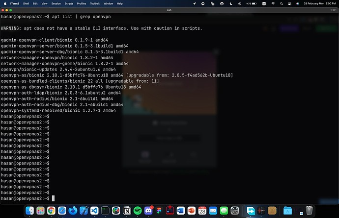

The doc tells me to change the conf file under /etc/openvpn, but no such file exits there, I've tried looking in /usr/, /bin, /sbin, /opt/ etc...
I don't really understand what is going on, but I know for certain OpenVPN is installed since my VPN works.

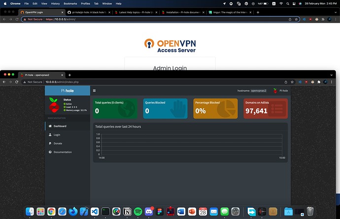

Also, accessing the PiHole panel works, but it is kind of weird.
If I go to http://10.0.0.5/admin I get the OpenVPN admin panel, but if I go to http://10.0.0.5 I get the PiHole panel that says "Did you mean to go to the admin panel?", if I click that prompt it sends me to http://10.0.0.5/admin which is the admin panel of PiHole. If I use the public IP of my VPS instead of the network interface it works fine for OpenVPN.

I'm worried if I do apt install openvpn it's going to mess up with my installation.
OpenVPN is not the same as OpenVPN Access Server.
The former is free, the latter is a product with a licence for two free VPN client connections - if that's not enough, you'd have to purchase additional licences (in batches of 10 at a time or so, IIRC).
The guide refers to the free OpenVPN.
