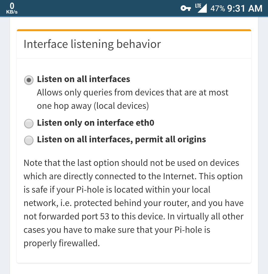

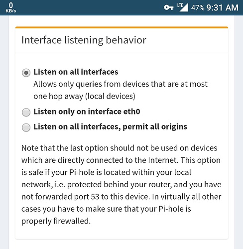

Have you enabled this option in Pi-Hole?

It was set on "listen one on interface eth0".
Having not changed any settings everything is working with the travel router connected to my home network. I'll change it to "Listen on all interfaces" and find somewhere else to connect to in the next few days to test it.
No dice. I set the Pi-Hole to listen on all interfaces, set up the router outside my home network, and still no ad blocking. The individual certificates still work with ad blocking. The connections through the travel router don't block them. I thought for sure that would do it.
