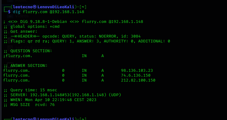

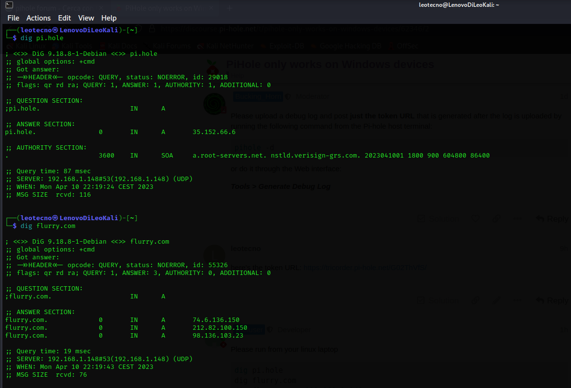

Please run from your linux laptop
dig pi.hole
dig flurry.com

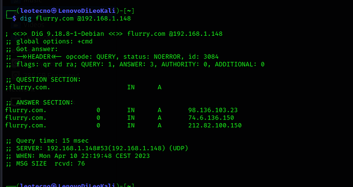

dig flurry.com @192.168.1.148
The results are a bit unexpected, esp. the returned A record for pi.hole Your Pi-hole should have answered with its own IP 192.168.1.148 but instead it answered with the public IP 35.152.xx.xx.
