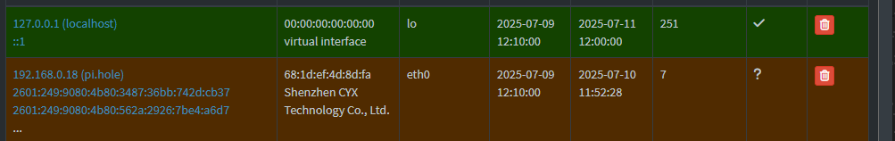

Nothing shows up in the query log. This is what the network overview shows when I log into the pihole admin. Is the localhost the desktop pc that I am trying to run the command from?
This demonstrates that your nslookup never made it to Pi-hole.
This is further supported by:
If it would have been Pi-hole processing those requests, it would have read Server: pi.hole instead of UnKnown.
