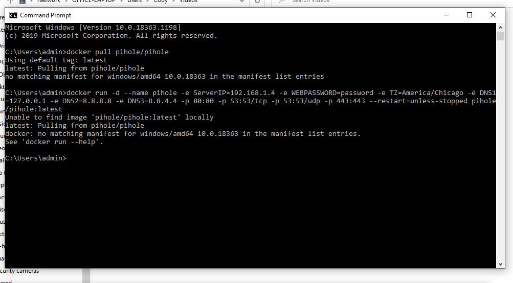

The instructions you linked me is how I setup pihole in the past. In my attempt to update docker and pihole to the latest version/FTL, I must have screwed something up. I tried to uninstall/reinstall docker docker but that didn't help. If I try to pull a new pihole this is what I get.
We don't make a Windows/amd64 image.
