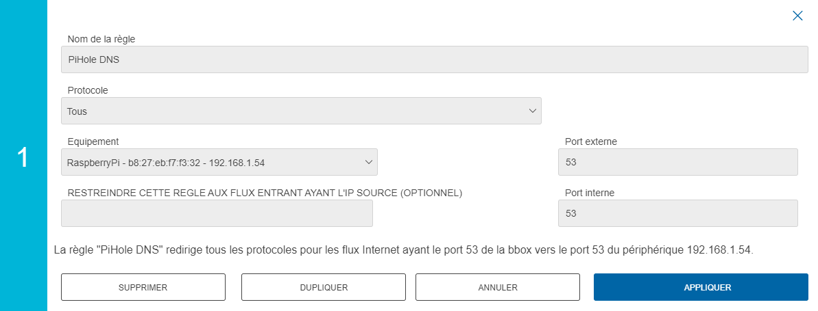

This indicates that port 53 traffic is not being routed to this IP. Check both your Pi and router for any firewall rules that may be blocking this traffic (and on the router, check for DNS rebind protection).
Oh, you're right.
I forgot to enable back this rule on my router.
Is my router having some bugs ? I'm not aware of any DNS rebind protection on my router.
