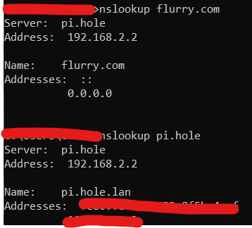

From a client that you expect to use Pi-hole for DNS, what's the output of
nslookup pi.hole
nslookup flurry.com

@Bucking_Horn I ran the commands on my laptop (which seems to have ad blocking working) and I got these results in command prompt:
(edit: whie tailing pihole.log I do not notice any entries that pertain to my phone's local IP address there after a few minutes. Now I'm wondering how it's bypassing the piholes (both of them))
The output from the command above shows PI-hole is correctly working and blocking ads for your laptop.

Your nslookup results show that Pi-hole has been used, at least for those requests.
Let's try to rule out those IPv6 by-passes that yubiuser mentions.
