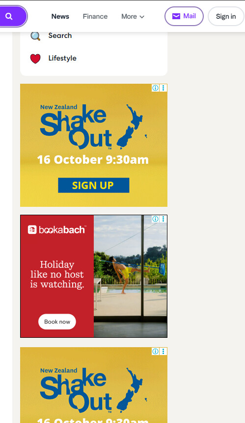

When i go to a random site to check for ads - yahoo.com
I’m still seeing targetted ads down right hand side
That's looking ok - no IPv6 addresses in your ipconfig's DNS Servers section.
