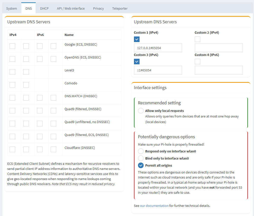

Wit the following DNS config, I'd expect PiHole to use the the local instance of dnscrypt which is running (and verified to work on its own with dig @127.0.0.1 -p 65054 pi-hole.net) on the same host:

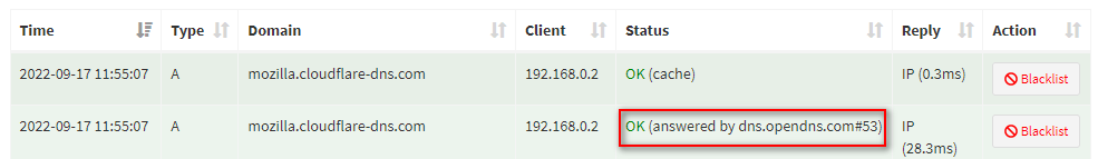

What I see instead in the query logs is that PiHole still uses OpenDNS to resolve.

however, this is not reflected in the UI and the dnscrypt address is also present in /etc/pihole/setupVars.conf which looks like this:
DNSSEC=false
CONDITIONAL_FORWARDING=false
WEBPASSWORD=xxxxxxxxxxxxx
BLOCKING_ENABLED=true
PIHOLE_INTERFACE=wlan0
IPV4_ADDRESS=192.168.0.111/24
IPV6_ADDRESS=fd00::ba27:ebff:fee0:6286
PIHOLE_DNS_1=127.0.0.1#65054
PIHOLE_DNS_2=::1#65054
QUERY_LOGGING=true
INSTALL_WEB_SERVER=true
INSTALL_WEB_INTERFACE=true
LIGHTTPD_ENABLED=true
CACHE_SIZE=10000
DNS_FQDN_REQUIRED=true
DNS_BOGUS_PRIV=true
DNSMASQ_LISTENING=all
