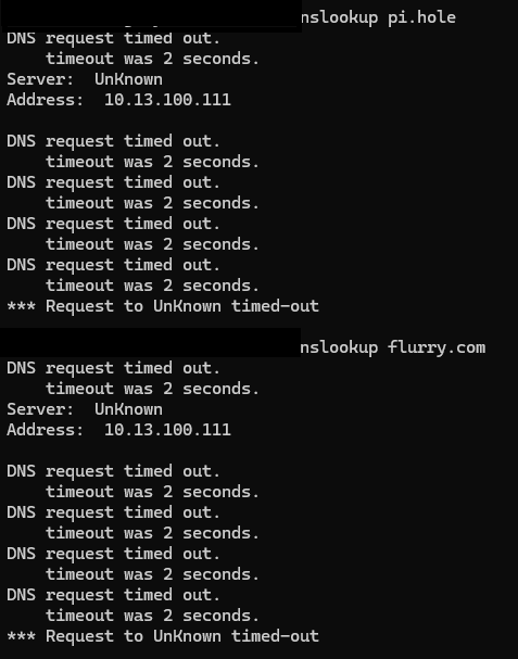

From a client that you believe should be connected to the Pi-Hole for DNS, from the command prompt or terminal on that client (and not via ssh or Putty to the Pi), what is the output of
nslookup pi.hole
nslookup flurry.com

I've manually configured the DNS on my primary Internet connection on my router to use a public DNS so that I can still reach my router from outside if pihole would stop working. I've configured the individual VLANs to use the pihole DNS.
