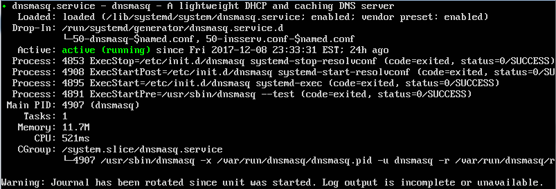

sudo service dnsmasq status

Hello Mcat12,

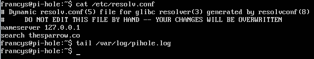

Thanks for replying, this is the output of that command:
How about the output of this command?
tail /var/log/pihole.log
Returns nothing

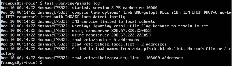

Run sudo service dnsmasq restart and then run that tail command again.
This was returned:
That looks normal. It's reading 106,009 domains from gravity.list. However, looking at your log, you seem to be running named, which will conflict with Pi-hole since they are both working with DNS. Please try disabled named and then see what happens.
