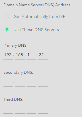

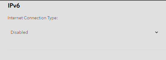

Reply For everyone, first. I have set a windows PC on my network to directly connect to the PiHole as its DNS, I will see how it performs. Second, my Router model is: AX1800 WiFi Router RAX10 which as can be seen on the attached screen shots only has one DNS server set and iP6 is disabled. Also third, I thought per documentation it was preferred to let my router handle the DHCP?
It's not a problem to let your router do DHCP, but it needs to tell devices to use the Pihole addresses (IPv4 and IPv6) for DNS queries. It appears that your router cannot do this.
So, I think you will have to use the Pihole as the DHCP server, if you want your devices to use the Pihole (directly) for DNS queries.
Maybe I am confused, but the settings I posted above I thought are telling clients to use the router’s assigned DNS, or maybe I am missing something. Also does not have any fall back, just the PiHole DNS listed.
No. I checked your Netgear AX1800 WiFi Router RAX10 router's manual, and that confirms that the router will tell all clients to use it (the router) as the DNS server, and with your DNS servers setting, the router will send all the DNS queries that it receives, to the Pihole.
