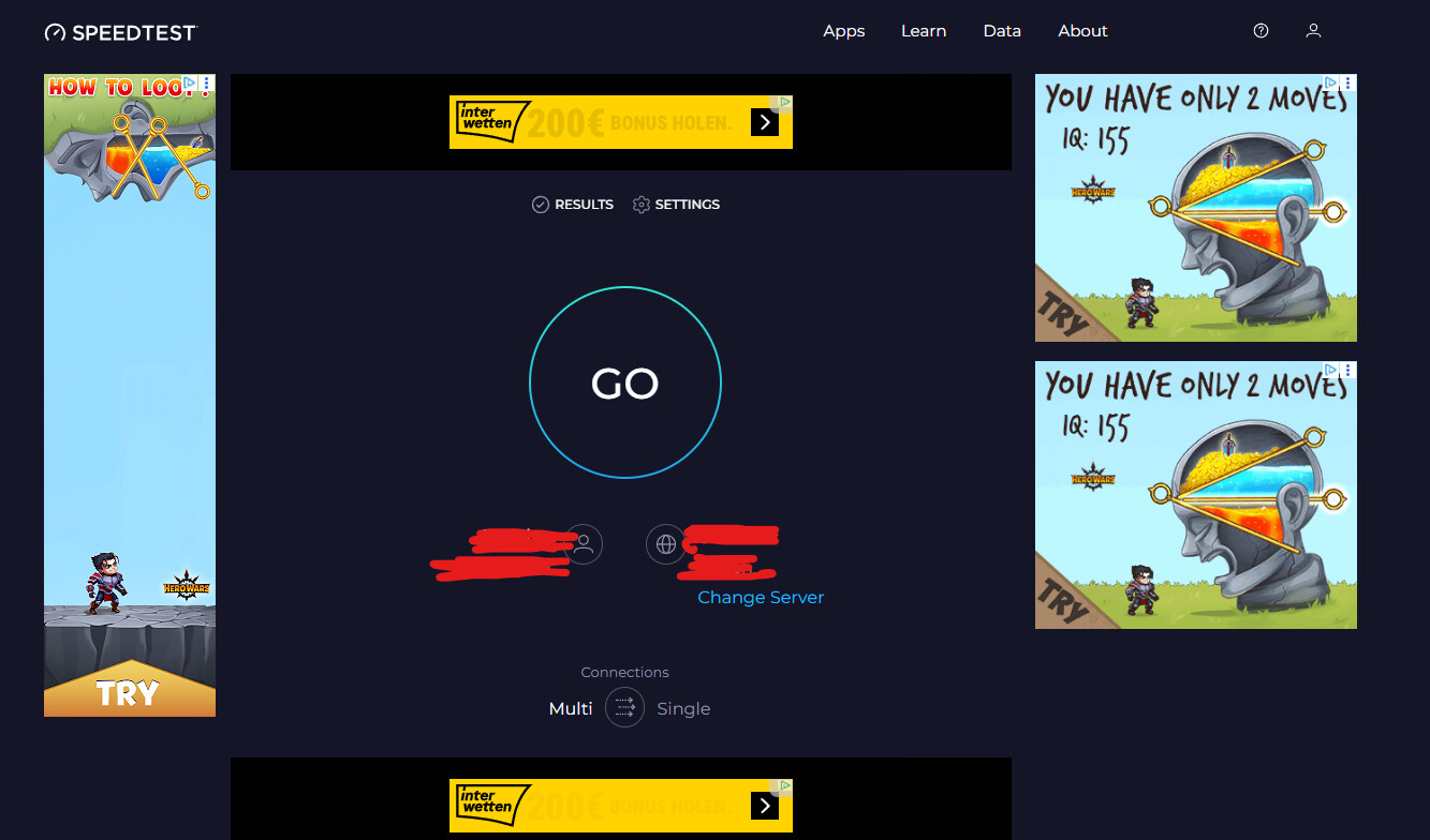

Sorry, I must have worded it poorly. I meant to say that all the requests I see in the logs that are from my phone only lookup google.com, when I go to a page like speedtest.net, where I know I will find ads, nothing new appears in the logs, and the ads show up on my phone.
Ads on speedtest.net do not get blocked either when visiting from my computer.

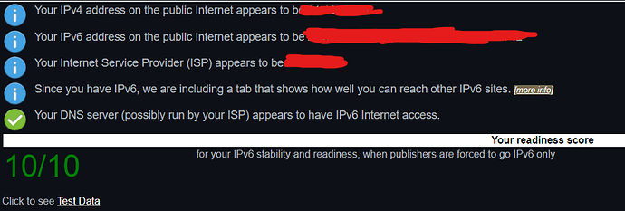

Can you visit a site like Test your IPv6. on a client and see if they are showing DNS over IPv6?

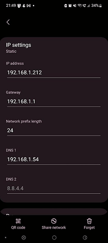

And the config for the samsung phone:
And the ipv6 test results:
Ads still show up on speedtest.net (from pc)
Did not attach the phone config right, sorry.
here is it:
It looks like your clients are using an IPv6 resolver to get the ads. Can you disable IPv6 on a client and see if you still get advertisements? On the Windows box you can untick the 'Internet Protocol Version 6 (TCP/IPv6)' box.
That has fixed the problem for my pc.

try removing the 8.8.4.4 from DNS2 from your phone and leave it blank

The 8.8.4.4 dns is greyed out, the field is empty. I'll probably set it as the cloudflare DNS.
