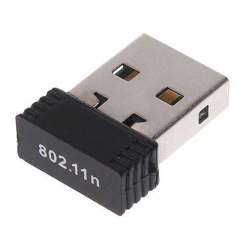

As a note to everyone who still has this problem, I tried the solution in here and it helped me so far (12+ hours without dropped connection). Will keep updating...
Edit 1: Running pass the 24hour mark, WOOHOO! I think its finally working properly!
For everyone who landed here, please try the link I posted above.
Tested on Pi zero W, wifi only no cable dongle

I don't have a wifi dongle, so I'm not sure that 'Disable Wifi Power Management' link is relevant, however, when I run ' iwconfig' on the RPI it indicates:
'Power Management:on'

@DanSchaper , where would you apply the power saving option ?
Its weird that ifupdown has a power saving option and dhcpcd5 doesnt ... to my knowledge.
Only options I can think of/that I found are:
via wireless-power option in ifupdown;
or create a systemd unit with the iw command to disable power saving;
or instruct the driver module to disable power saving when loaded;
or create a hook for dhcpcd that runs the iw command;
or schedule a ping to prevent going into power saver mode.
In the module.
https://www.raspberrypi.org/forums/viewtopic.php?t=61665#p631098
https://www.raspberrypi.org/forums/viewtopic.php?f=66&t=193437&p=1212183&hilit=disable+power+savings#p1212183
Yeah that sounds as the obvious place.
But that means there is no one size fits all solution as you have to figure out what module is used for your WiFi and if the option to disable power saving is available.
