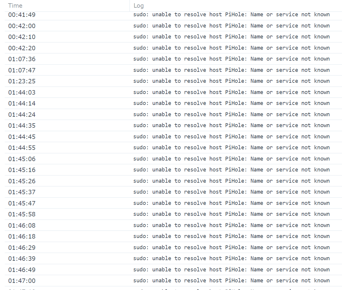

I don't find the daemon error in my logs but I do see a whole hell of a lot of these
