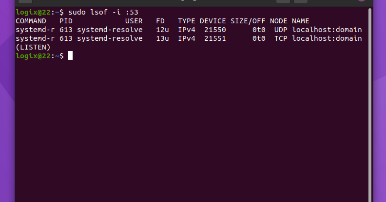

I figured out the issue.
First, answer to your question is its using bridge network so the dns will be same as casaos/main linux os ip.
My port 53 was used by default os dnsmasq, because of this I used port 54 to install pihole. So I have free the port 53 and reinstall pihole.
Steps I followed
Step1: follow this guide to edit the resolve.conf file
Step2: systemctl stop dnsmasq
Step3 systemctl restart systemd-resolved
In most of the guide they didn't mentioned step2.
Note: if you are using casaos dont put local address as dns in resolve.conf file otherwise casaos will be unable to download file for pihole
